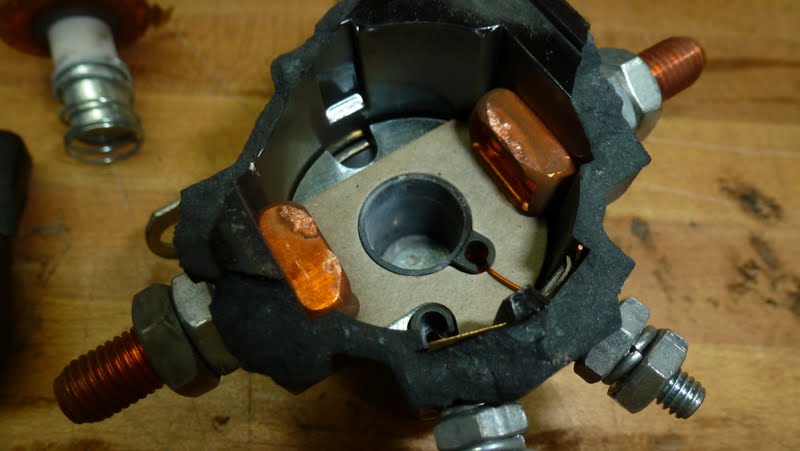

First, I tend to agree with the guys who say that we should think about doing away with the starter solenoid, now that we are all using non-Bendix starters. Heck, Sky-Tec actually comments on their page that they don?t know why Van?s still show them on their drawings. Well, some habits die hard?.and rewiring takes time, so maybe I?ll get rid of mine someday. In the meantime, here are some autopsy photos:
This is the solenoid with the top ripped off. Looks Ok from this vantage point:
Ahh?.but take out the plunger and take a look at the contacts! They are nicely pitted ? and not symmetrically.
Originally Posted by barryrv10 View Post
It is important when you tighten the nut on the stud, that you back up on the locking nut so the stud does not turn. The connection inside the solenoid is two flat surfaces and if the stud turns you loose that good connection.
I think Barry hit the nail on the proverbial head!
And here is the ?underside? of the plunger contact ? note the pitting, and the fact that it clearly rotates during its life:
I cannot believe how much changing a $21 part changes the character of a 1500+ hour airplane! Whereas I was beginning to think I had to baby it on every start because it barely got over TDC, now I can once again practically taxi on the starter. The thing is, these go bad gradually over a lot of hours, so you just don?t notice how bad it is getting ? like boiling a frog. So if you have a slow starter ? think about changing your solenoid (or eliminating it). And remember, we have to put SOME parts in to keep the aviation economy going?
