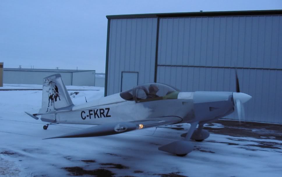

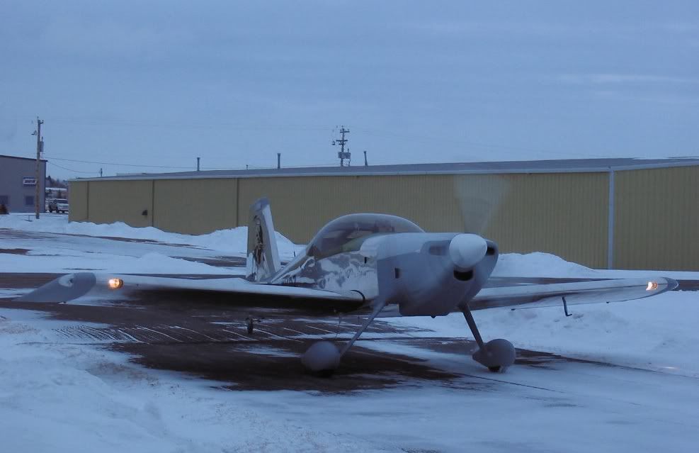

It was a cold, grey day at Springbank Airport CYBW this afternoon but this was the day that the turbocharged Subaru powered 7 C-FKRZ built by RV guru Ralph Inkster finally broke the bonds of earth. Sounded great and performed well at reduced power settings for the 45 minute flight.

I advised on many aspects of this FF package, turbo, EFI, intercooler, rads, ducting etc. Ralph built the plane for a customer, Shane Getson.
The engine is an ex Eggenfellner STI block with the Eaton blower mess removed and replaced with a custom matched Garrett T4/ T3 hybrid turbo. The factory EFI was replaced with an SDS EM-4 4F driving the factory coil on plug units and injectors.
Uses an MT prop and Egg Gen 3 gearbox.

The owner had this built to go fast. The engine is easily capable of making 250hp at 5000 rpm and 50 inches which is 50 hp and 1500 rpm below the stock engine power rating. Randy Crother's similar machine could easily exceed redline in level flight at power settings well below this. This is really about how much fuel you are willing to burn. The climbout was around 1000 fpm at 120 mph running only 30 inches and 4800 rpm. It's doubtful we'd need to run more than 4500 rpm and 40 inches to true 200 knots at say 12,000 feet.
For the most part, most Gen 3 boxes have been holding up ok at the 160-200hp level aside from some annoying front seal leaks. Randy has run his hard above these levels and it's holding up. A bit of an unknown. A few bearing problems have surfaced and issues with the input shaft snap rings on a couple boxes but these do not seem to be across the board.
This aircraft has substantially different radiators and much more area than any other Subie RV flying, ditto on the oil and intercoolers. We don't expect any thermal problems in hot weather but only flight testing in the summer will prove this. Everything ran way too cold on the first flight so we need to make a few changes to keep Ted and the engine warmer.

The overall cooling drag may be higher than on a Lycoming due to the margin needed to cool this more powerful engine and the intercooler drag but up high this is easily offset in the thinner air. The cowling uses nearly stock cheek inlets for the rads, the chin scoop for the oil cooler and NACA ducts to feed the intercooler and third internal rad. Discharge air for the intercooler and internal rad are carefully channeled to the cowl exit to minimize turbulence and an offsetting pressure rise within the cowling. Ralph did a very slick job with all this.
