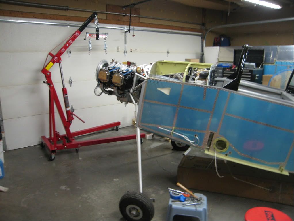

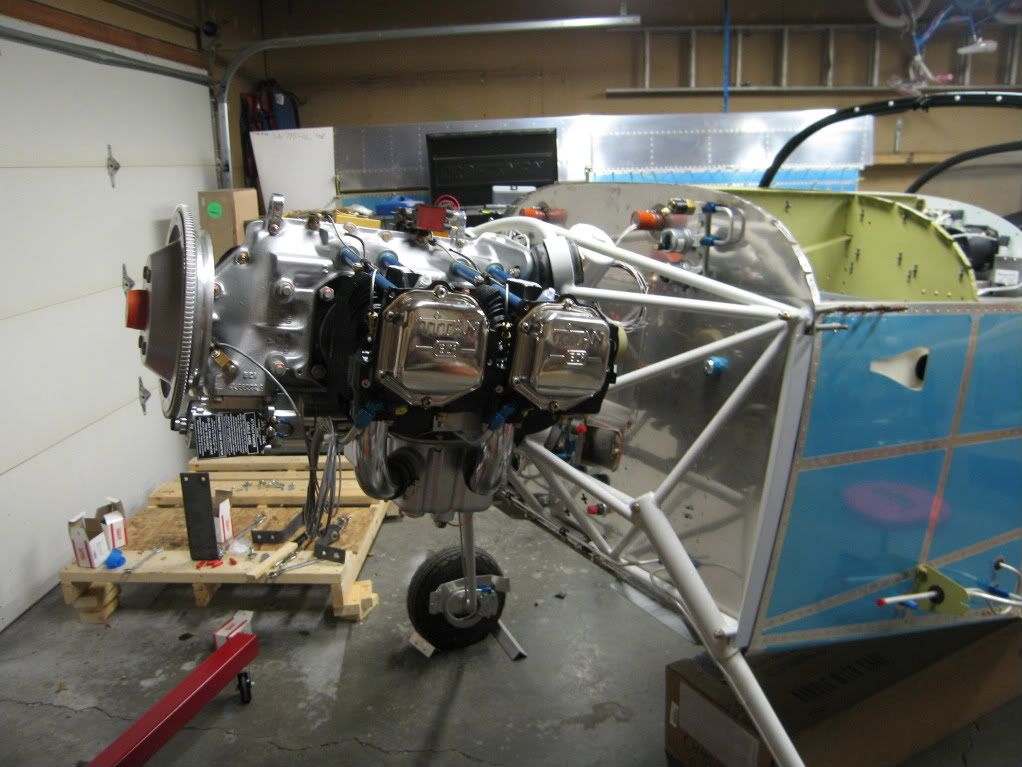

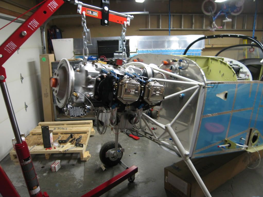

Today I decided to try to mount my engine - solo. I thought about asking a bunch of people over to help, but using the wealth of knowledge obtained on VAF, including the "Illustrated Guide to Engine Hanging" available here: http://www.vansairforce.net/articles...inehanging.htm, I thought I could try it myself. What the heck, if I run into trouble I could always ask for help.
My engine is an AeroSport Power IO360-B1B ECI engine with vertical induction. The mounts are Lord p/n J-9613-40 mounts.
Once I got the engine on the hoist, it only took me a little over an hour and it was mounted. All mounting bolts went in very easily, especially the first 3. The 4th only needed a little coaxing to get it lined up, but it was really not difficult at all. Maybe I got lucky...

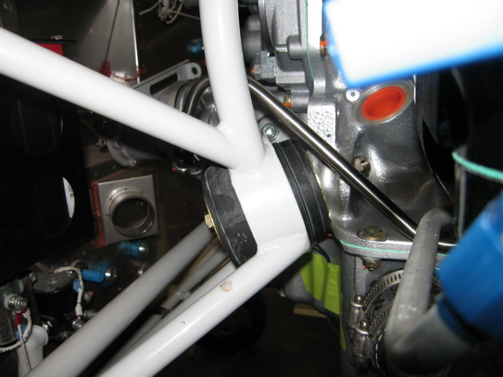

Frank, That's what I did and it works. First I installed the upper starboard bolt and tightened it all the way. Then the upper port bolt (I had to loosen the upper starboard bolt slightly to get the 2nd bolt to align). Then I tightened the 2 upper bolts all the way and installed the lower starboard bolt with no problem. With those 3 bolts tightened all the way, I was then able to install the lower port bolt after using a big tapered punch to gently align the holes. Easy peasy.
I did have to remove the oil filter from the angled adapter to get everything to clear the engine mount. So now I still have to re-tighten and re-safety it.
