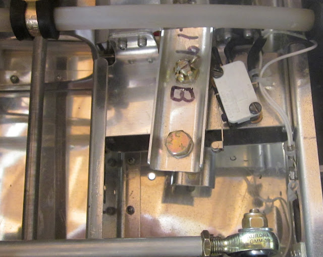

I installed a microswitch on top of F-1218 to monitor the flap position. F-1218 is on page 21-04
Purchased this switch: http://www.mouser.com/ProductDetail/...MFFmOyeQ%3d%3d
This is a work in progress. When completed, the switch will turn on a one minute PIC12F509 timer.
This will give time to make a landing. If the flaps are still down after one minute, the Dynon will alarm.
Old forgetful minds sometimes forget to raise the flaps, not good if the airspeed exceeds 80 knots.
Below is a picture of the Dynon displaying FLAP.
The Fuel Temp is not operational yet. That is a future project using the
Dynon D-180 GP Thermocouple input (EMS Pins 27 & 28).
Joe Gores
