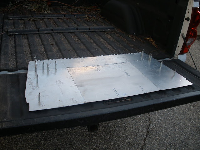

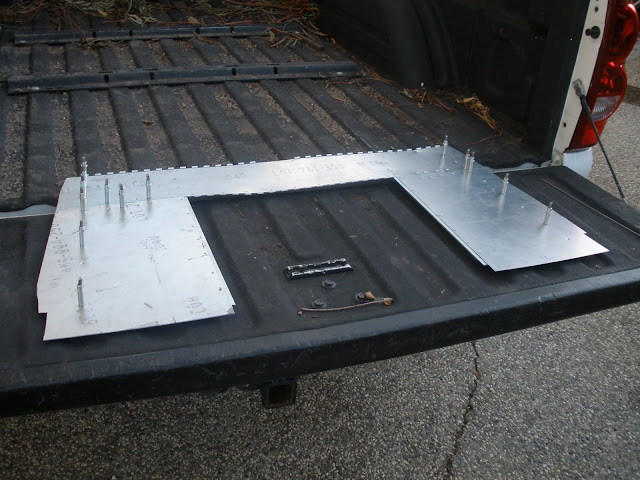

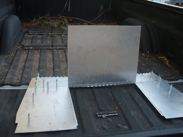

What is it???
A little more of the puzzle
Last piece
Answer???

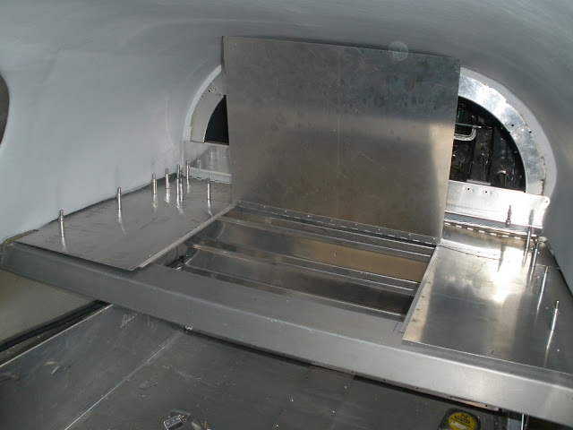

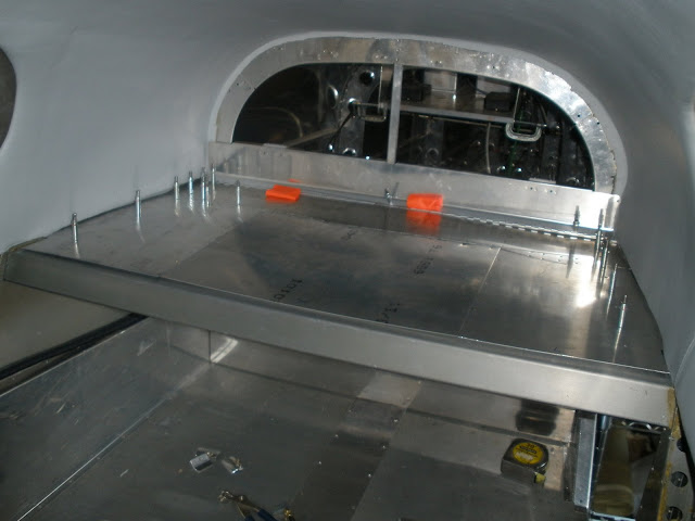

O.K., here is what a few pieces of scrap scrounged from the shop looks like after it is installed in the back of the 10.
This is a package tray above the cargo area, behind the rear seats, will be covered with a piece of carpet.
I decided to use a lift up hatch for two reasons-------I am using the Classic Aero rear seat, without any opening between the seat backs, and I am too cheap to buy a new sheet of alum big enough to make it in one piece.

Very nice Mike! Will the entire shelf be easily removable?
Pull two hinge pins at the bulkhead, and it drops down and comes out the baggage door.
If you are slow, maybe 15 seconds??
The two orange things in the photo are flags on the temp hinge pins I am using, they are inserted from the center toward the sides.
I like these wire markers, used by utility companys and such, they make good test pins, and the flag makes it easy to find them when you drop one on the floor.
