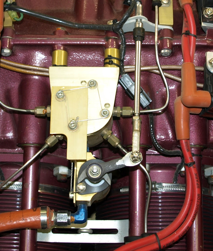

Don - how about posting a picture to make it easier to identify the part.

Default Here's a photo from my -4
I believe the fitting Don is referring to is the blue nipple located bewteen the flow divider and the purge valve.

Dean, off topic, but important. A fellow here lost power on take off because of a wire break in his purge valve controller cable. He had the same type you have. Something to consider. I used a push button lock cable (Spruce A770) with a 10-32 clevis as shown here:

[quote=AlexPeterson;362332]Dean, off topic, but important. A fellow here lost power on take off because of a wire break in his purge valve controller cable. He had the same type you have. Something to consider. I used a push button lock cable (Spruce A770) with a 10-32 clevis as shown here:
Nice set-up. I plan to install a "fail-open" spring when I install the SS nipple. The set-up you have is much cleaner, but too much work at this point. I think I will archive your photo in my "future upgrades" folder.

My controller cable is the cheap kind, but I also put a fail-open spring on there. HIGHLY recommend that for anyone's AFP installation.
