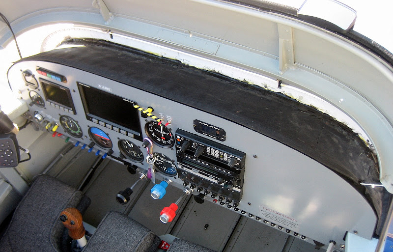

I've posted this before, but here is a very helpful measure towards protecting the avionics. It doesn't keep the water from seeping in (mostly at the tip-up hinges), but it protects the expensive stuff pretty well.
The material is a waterproof nylon and I occassionally spray it with Scotchgard. We glued it to the firewall and use velcro on the other three edges. Of course, there is also weatherstripping that the tip-up rests on when closed.
Another source of water coming in is the cabin ventilation scopes. I suppose you could duct tape them when you expect to fly through rain. I haven't done so, and I've had damp maps in my pockets.

Thanks for the replies, I'll get busy. Louise, thanks for the re-posting of the picture, I'm going to give a try.
