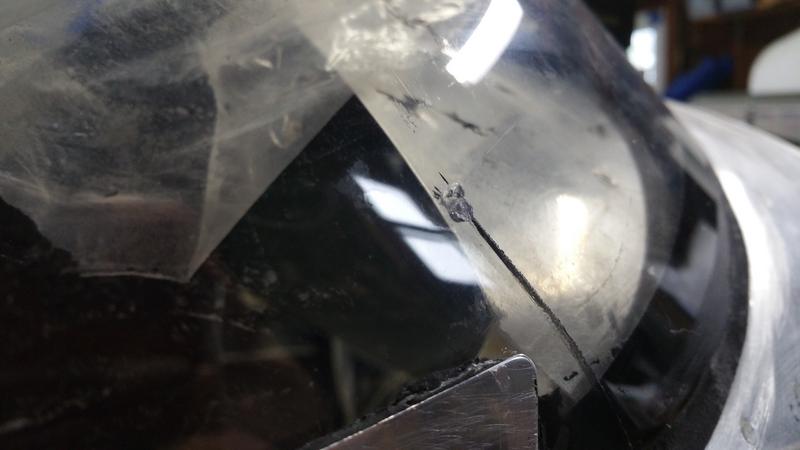

I had a crack in my canopy and decided to fix it as well as I could using the weldon products. I drilled a hole using a plexi bit to stop the crack. I filled in the crack with the thinner weldon #3 and sanded it down so its smooth. I then filled the stop drill hole with #16. I checked it about an hour later and there were little spiderweb cracks emanating from the hole. I had no idea how they showed up. I drilled those out and just filled those holes with the 16 again. 10 minutes later more cracks showed up. I drilled a bunch of practice holes in some scrap and can't get any cracks to show up in the scrap pieces. Why is my canopy cracking when I put the weldon in the hole?

Not sure, but my guess is that the weldon is expanding as it drys / cures. Try filling the hole with epoxy or clear silicone .

Because of the curvature internal stresses are high so its likely because of the holes you've stop drilled. I'm of the opinion that stop drilling cracks usually makes a crack worse. All it does in truth is shows others that someone has acknowledged a crack. I can't tell you how many times I've seen aircraft skins stop drilled with cracks emanating from stop drilled holes.

Weldon 16 is recommended for acrylic products but in fact it is a solvent based product containing a high percentage of MEK. It works by actually dissolving the acrylic. The problem here is that MEK is a double edged sword as it can break down the molecular structure of the acrylic and potentially cause additional stress cracking as you have found. The problem with the Vans canopies is that they are double curvature and the forming process leads to increased levels of internal stresses being locked in. Trying to repair cracks in Vans canopies can therefore be very problematic and is best done by a professional.
My guess is that you are going to end up replacing this canopy or you are going to have to live with something that looks terrible.
Many builders think that using the Sikaflex approach on their canopies will eliminate the problem of cracking but there is mounting evidence that this is not so.

Do you have any scrap pieces of the canopy? If you do; you can use a rasp to create little flakes, dissolve them in the Weldon and use as a filler. Thinking it used to work with the #3.
Never had any issues filling gaps or holes that way, thickens up as you add the flakes.
Only fill in a little at a time in thin layers if plugging a hole. Once done sand smooth with super fine sandpaper to get it to almost disappear.
