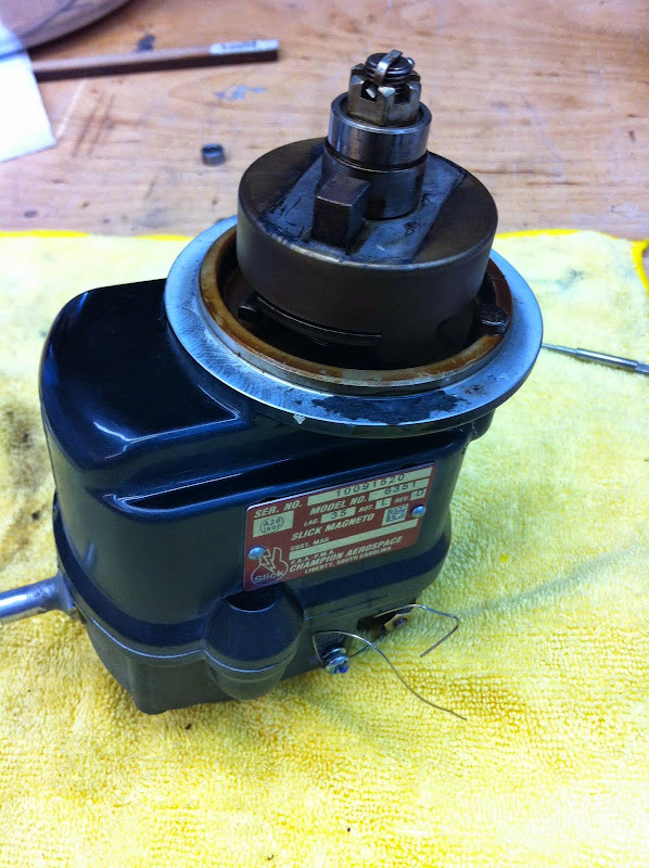

Originally Posted by N427EF View Post
A 250 hour inspection SB1- 98A maybe with the right tools.
Specifically the impulse coupling.
Tools needed: An impulse coupling puller and a rivet gauge.
Maybe this belongs into a different thread but Mr."Slick" Joe Logie was adamant about doing this inspection on affected engines/magneto installation,
saying that he had seen these fail in 300 hours.
He also said he would not fly an engine with 5th order counter weights and an impulse coupled slick mag. This from the folks at the Oshkosh slick booth.
He recommended a slick start module with a retard breaker instead.
(I think I'll just go with a second Lightspeed EI and be done with magnetos.
Quite simple really with the right tools.
Mine showed no noticeable wear around the affected rivets that hold down the pawls. I'll send it in for a 500 hour when it gets there.
-Andy Turner
RV-10 N784JC
