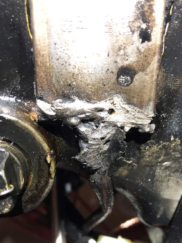

My experience with Reiff heaters and more importantly their service, was poor. Their product burned out after an estimated 20-30 times used over three years. They carry a 5 year warranty, but Reiff wouldn't honor it since I didn't purchase the kit and it's apparently non-transferable. They also felt like these were not installed properly (not enough epoxy used). That could well be, but if they replaced the $20 pad under a courtesy warranty, they would have had a customer for life. I'll try E-Z Heat on my new engine.

With respect to the post above concerning poor service from Reiff, they're a family-owned and operated company so I'm surprised they didn't go the extra mile. Looking at the photos provided it's clear the heat pads have far less than the recommended bonding agent applied to them.
It's pretty obvious the installer didn't even come close to following the installation instructions. That goo under the pads performs two functions... Firstly and obviously it bonds the heating pad to the metal oil sump. What most folks don't clearly understand is that goo also performs the critical function of facilitating heat transfer between the pad and the oil pan. Not enough goo means the heating element can't get rid of the heat it's making, leading to burn-out.
In this instance the burn-out of that heating element has a cause which is pretty obvious. If I were the manufacturer I'd certainly hesitate in providing warranty replacement, and perhaps more so to a person other than the original buyer.
