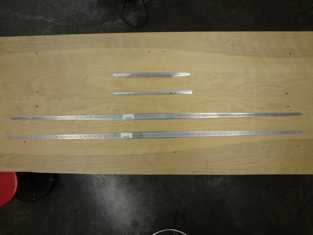

So.... back to my quest to update my build frequently, I tackled the spar and angle reinforcement bars (tapering and breaking) with a file. It took me a while to feel confindent that I guessed right on what the plan was saying when they wanted me to "break the edges" of the bars. I never heard that term before.

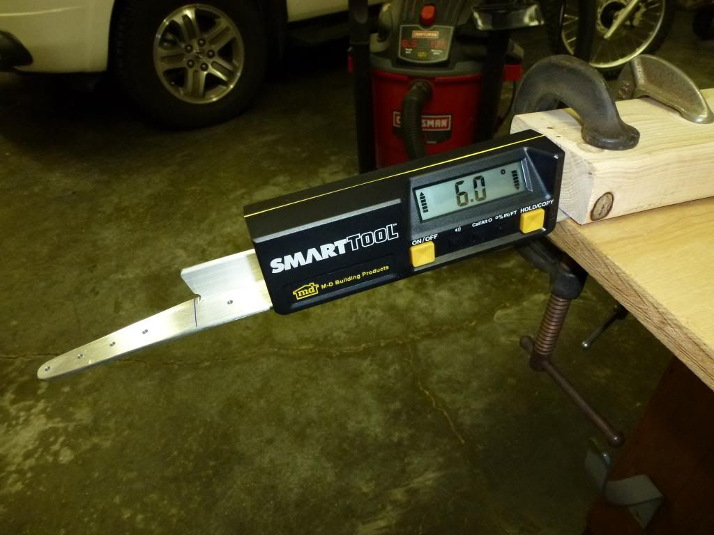

Having a project has been a great excuse to build up my tool collection. This smart tool was useful a few times on the tail kit.

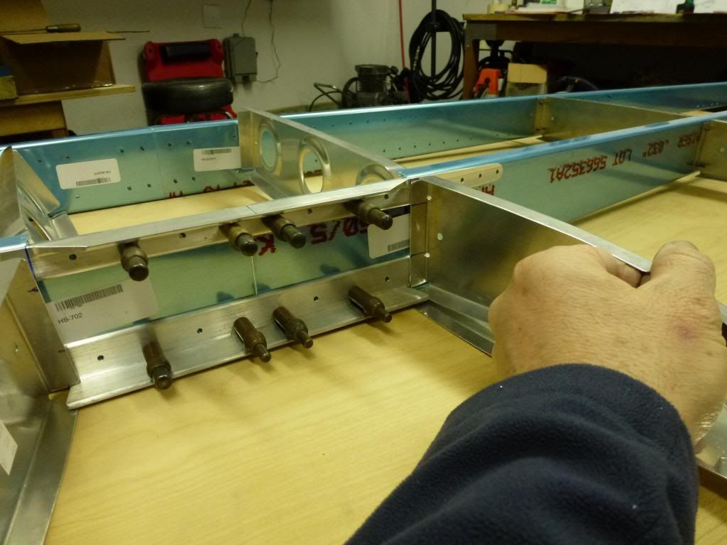

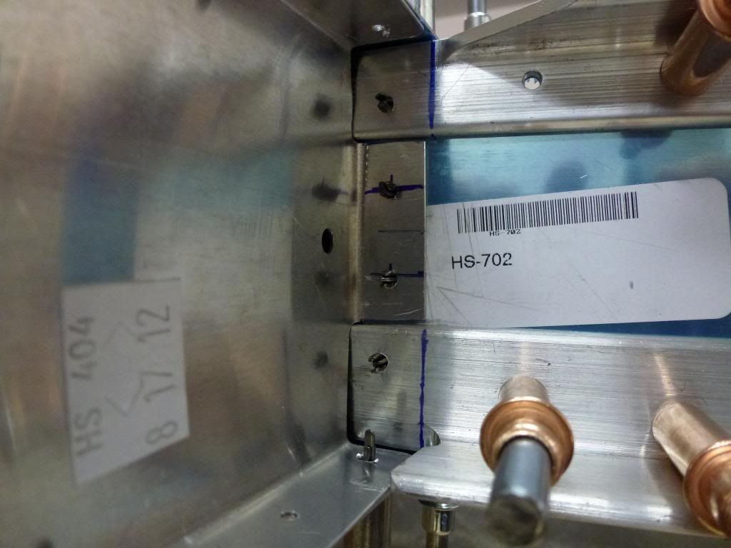

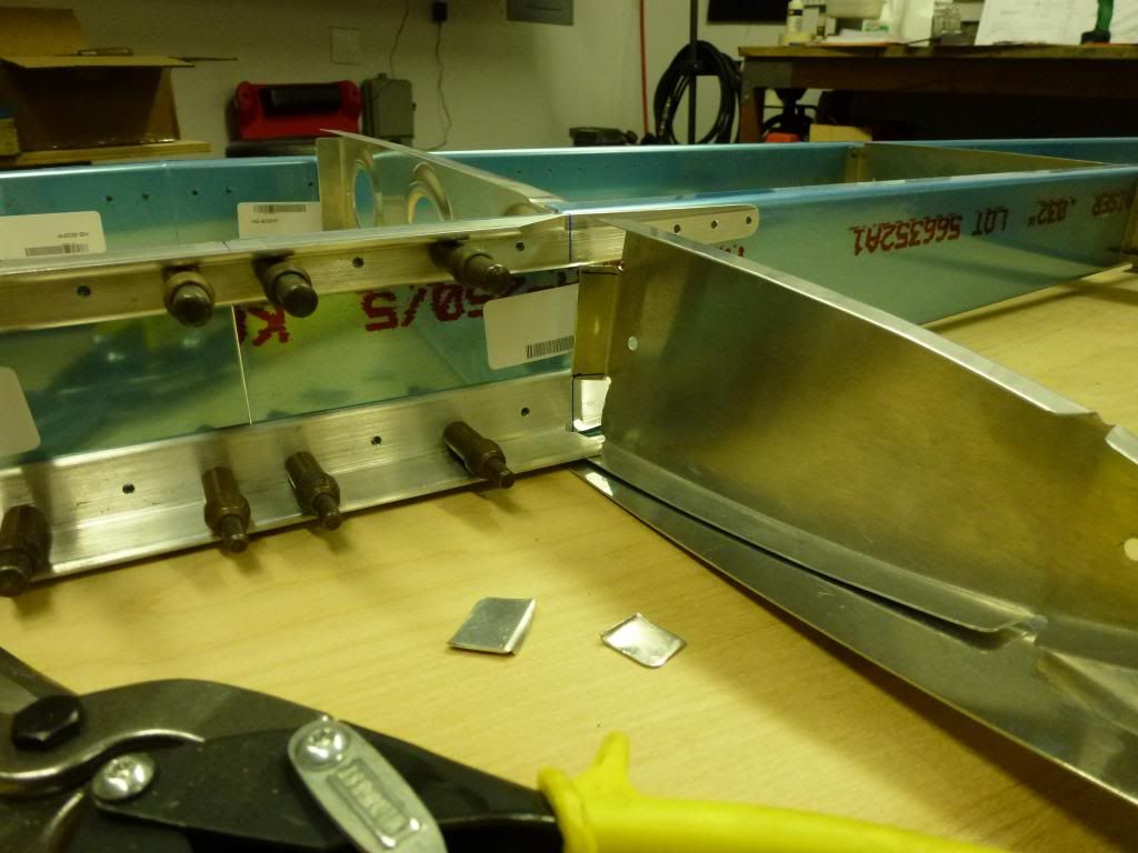

Then came the point in the project that so many had suffered with (cutting and drilling the HS-404 nose ribs). This can be searched and read until your blind. I had no idea how to do it better, but I approached the task with caution. The problem is "edge distance" on the rib flange that rivets to the HS-spar. I read the plans, measured and lightly marked the call out specs. Then I just through the nose rib up against the spar and eye ball'd the distance between the HS-810 and HS-814 and marked it free hand.
I wish I would have marked the call out line better so it could be seen in the pic, but I gained a pretty good chunk of flange by eye balling it. I then cut above and below my eye ball'd lines so I could file back to them as needed and threw the nose rib back up to the spar to evaluate where I was.
With just a little bit of filing the rib flange eased into just the right size (top to bottom) to squeeze in between the HS-810/814 angles.

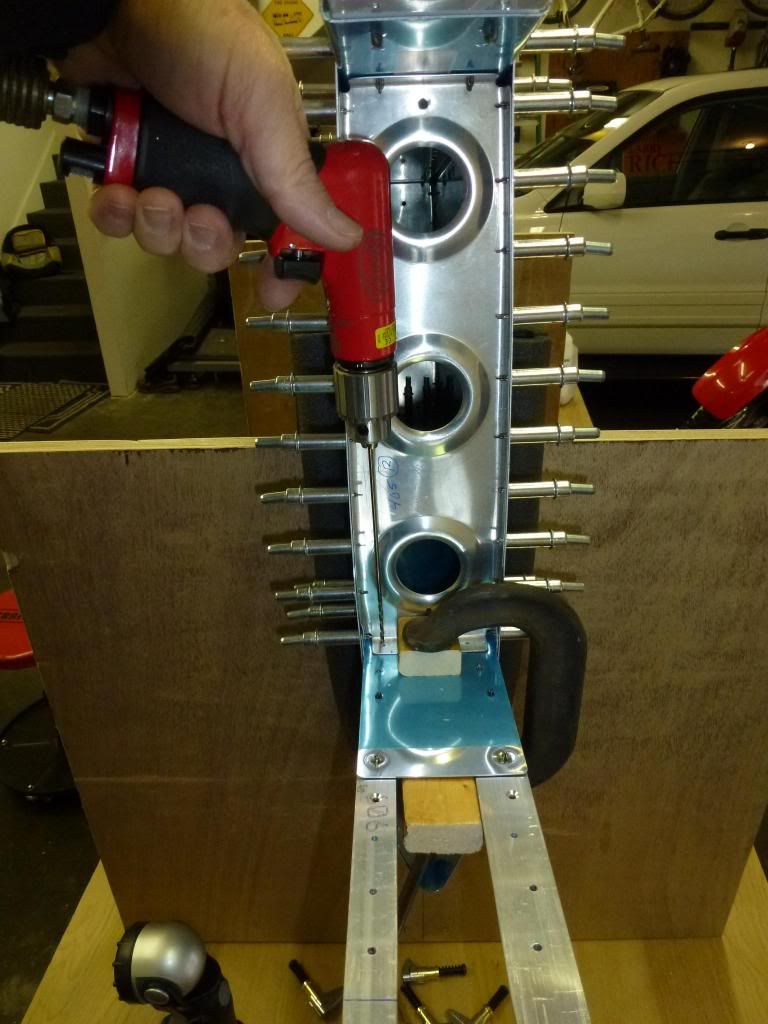

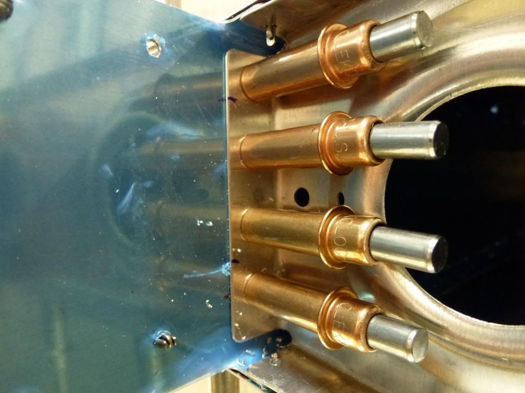

The next blood pressure raising event was to drill the 4 holes per side through the spar, 810/814 angles, front and main ribs.
Of the 4 holes, the inner 2 now gave me lots of rib flange meat to drill through without being too concerned with edge distance, but the outer holes (upper and lower) challanged me for edge distance between the main rib flange (drill going through it in the pic above) and the 810/814 angles.
When it was all said and done I felt it came out OK. All the edge distances were withing specs. All the reading and viewing of pictures prior to tackling this was very helpful, but in the end just having the parts in my hands and fiddling with them was the most comforting tool to believing I could successfully complete the task.
