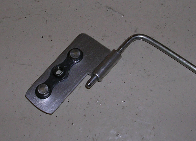

A few of us have had the RH side lower, longer, cowl hinge pin work itself up after a few hours. I took pictures, but was too close, and the pictures are not very good. I made a new pin with a LONGER offset, and another up-sweep at the end. After installed, I can swing it around and UNDER the edge of the oil tank bracket. You just have to bow it down a bit then swing it under the bracket. Will stay in place now.

I had the same problem of the cowl lower right hinge pin coming out. I do not know how the pin can fall UP, but it did. I fixed it by drilling out a rivet and replacing it with a 6x32 screw that holds a piece of hinge that holds the pin.
I did the same thing on the left side of the cowl. There are two more screws to take out when removing the lower cowl, not a big deal.

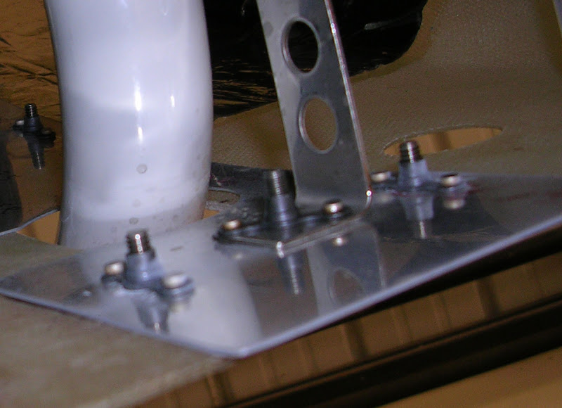

Those little metal locking nuts are a pain to work with. I replaced it with a nutplate on the lower cowl closeout. Now I do not have to use a wrench in an awkward position.
